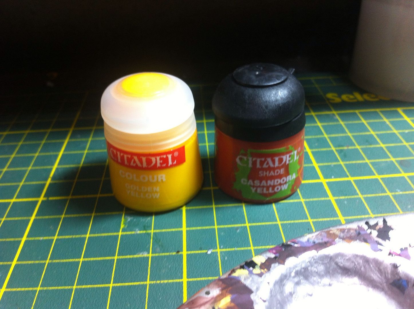

On to the washes. I tried the Casandora Yellow first. Don't let the bottle fool you. It looks orange in the bottle:

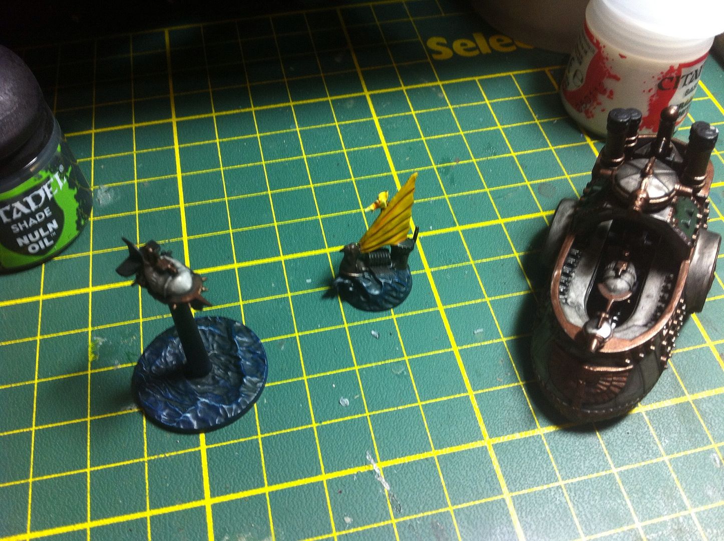

Seriously, don't let it fool you. Here's how it turned out, alongside the Nuln Oil over the Dirigibles:
The Nuln Oil behaves like Badab Black, but a bit better. It still greyed down the white, which I expected. But the yellow... Wow... it looked easily as good as the yellow on the sail, if not a bit better... and simply 2 steps. I can see a lot of Bad Moon Players using this technique... it's FAST and it works.
While I didn't take a picture of it, I used regular skull white to bring back up the Dirigibles, and it took really four layers to blend it up over the grey to an acceptable level.

Thanks for posting this Aga. :thumbs The yellow shade does look very promising. It's hard to tell from the pics - does it just tint the white base a flat yellow or does it provide shading as well? Looking forward to a review of the painting book. :cheers

It provides shading as well... I think so far the Ceramite White and the Casandora Yellow could be considered "revolutionary" or perhaps more modestly "evolutionary" when it comes to painting. Reducing bright yellows from what was often a multi-step process to a 2 or 3 step process at best is certainly a bonus. For some people, you can just skip the Ceramite White, prime the model white, and wash it with the Shade... and you're done... or you can highlight a bit if you really want to. :)

i cant wait to try the GOLD ughh, ok so you are saying a white prime and a yellow shade looks like a proppa yellow?
"I dont get it..."
  • 6,562 posts
  • Location:Calgary, Alberta, Canada
  • Army Name:Da Blue Thunda Speed Freeks
Yes. Bad Moon players are going to be VERY happy. :)
