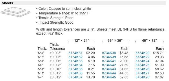

My friend and I routinely order styrene from this place: McMaster-Carr
http://www.mcmaster.com/#plastics/=khn3gy
It looks all industrial (it is) but they ship small orders for a reasonable price. They're close for us being in Minnesota but I would assume shipping is pretty close for most of the midwest. They've got tons of stuff, I mean a ton.
Choose the Polystyrene from the menu at left after choosing your type (sheet, tubing, rod, etc.)
Here's their cost/size for sheet styrene…
Like the other company mentioned earlier, they roll the larger sheets and ship them in a tall box, just enough to not deform the sheets or make them permanently curved.
