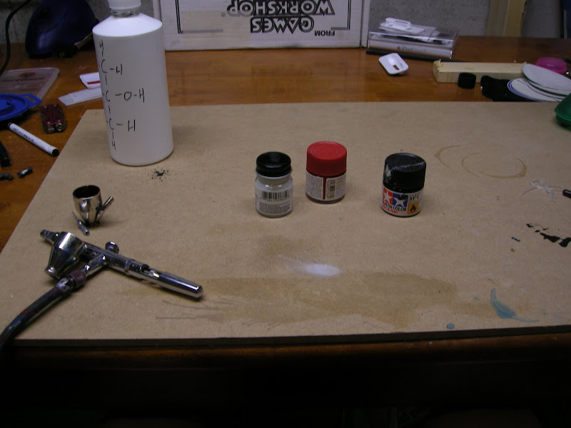

The Forgeworld Book says to buy the best one you can afford... and they're right. I did a hell of a lot of reading on these things before I committed to mine.
First up when doing an airbrush, you're not just getting the airbrush, but you're also getting a compressor if you want to make it work. The compressor will make up about 2/3's or more of the cost of your airbrush purchase. In my case, I already had the GW spraygun, which is effectively a single-action syphon-feed airbrush shaped like a flamer. The cans are really unreliable as an air source... and I found that out very quickly. Even so, the GW spraygun was enough of a taste for airbrushes that I decided to forgego models in favour of a new and very powerful painting tool.
There are 2 general types of airbrush on the market: Single action, and dual action. Within each type there are syphon-feed (from the bottom), and gravity-feed (from the top) as to how paint actually gets into the airstream.
In my case, I purchased a dual-action gravity feed airbrush, with a cup on the top of it large enough to hold about 7mL of paint. The brand I chose is a less well known one from a company called "Grex" -specifically the Genesis XG, as well as the compressor designed to go with that airbrush.
Here's a picture of it:
Of the page you linked to, the brand I am most familiar with is the Iwata. They are considered to be the best and most available of all the airbrushes. My Grex airbrush and compressor is actually compatible with the Iwata ones... but Grex is harder to find.
If anything, I'd suggest this link off of the page you went to:
http://www.everythingairbrush.com/acatalog/Iwata.html
And the third item down on the list, AB-AS-18 Airbrushing kit with the Iwata Eclipse CS is pretty good, and is similar to what I have. It's a dual-action gravity feed. The cost on that kit is roughly similar to what I paid for my stuff on sale.
From what I understand, Iwata brushes are in many ways the industry standard for quality. Badger is more common a brand, but most of their stuff is entry level.
The one thing I've learned very quickly... cleaning your airbrush will be something you will become VERY familiar with. smilingOrk.gif You will likely spend as much time cleaning the brush as you will be painting with it, but since it cuts your painting time down incredibly, especially with vehicles, that's a fair trade. It's really not that onerous.
Once you have the airbrush, then it's about learning techniques. I can give you some references for that later, because until you put the brush in your hand it won't make a lot of sense.

I'll throw my $0.02 into this discussion... mostly to second points already made (lots of good info here already).
I have an Iwata Eclipse (forget which one, just the regular bottom feed one, pictured below). It goes for about $150 cdn these days. I've had it for almost 11 years now, and have only replaced two parts in that time. As mentioned, having access to replacement parts is a great thing... I can get whatever I need at Curry's art store (a great source for anybody in the greater Toronto (Ontario) area).
After purchasing it I got a couple little cups (also pictured below). When I bought it I thought the large bottles would be better, but for models this isn't the case. When I was in university I did some set painting for stage productions, and the big bottles came in handy there. As mentioned, you typically use very little paint when doing models, so mixing up enough for a bottle is a waste. If I were to do it again I'd get the type with the cup built in and above (as in Agatheron's pic).
I have a badger compressor. Its small and portable, but if I have the option I prefer to use a normal compressor (with a tank and pressure regulator). A couple reasons for this... 1) my small compressor only runs at one pressure (I like to be able to adjust this for different thicknesses of paint). 2) I get condensation problems with my small compressor. I have an inline condensation trap, but it doesn't work. I find I get less condensation when using a larger compressor. 3) My little compressor goes on and off every time I spray, and this gets a little annoying. A larger compressor, while loud, cycles less frequently because it builds a lot of pressure at once and I'm only drawing it off at 15-20 psi. I also find that I get a lot less condensation when using a compressor. I think this is because the air will cool while under pressure and this helps with the thermodynamic phase changes. I've never used the propellant cans, but I hear they are expensive and unreliable.
As mentioned, cleaning your airbrush is #1. This cannot be stressed enough. Because of this I usually discourage people from the airbrush purchase. Unless you have tried one out and seen this first hand I don't think people understand how much of a job this can be. Over the years I've had lots of issues with cleaning it out, and know it inside out. I've used harsh cleaners (Acetone) and ruined the o-ring, had it gum up, spatter paint and everything else. I know I'm a bit lazy in this department, but there aren't really any short cuts here. Currently I find rubbing alcohol works well as a cleaner... and its cheap. I have it in an old contact lens fluid bottle because it has a nice nozzle (its the bottle in the background below).
Using proper paints will help a lot with cleaning. I have a bunch of airbrush specific paints and these thinned down with airbrush medium (I use liquitex stuff, but most brands have their own). Tamiya paints are fantastic, and thin down great with isopropyl Alcohol but I don't like pouring them from those bottles. I'm hoping to give reaper paints a shot soon. They would be the preferred option (for me) because of the eyedropper bottles.
All that said, its a great tool, and you can get some amazing results, but it takes practice and patience. It will be one of your more expensive hobby tool purchases, so do it wisely. If you can, find someone to show you one and how it works. Take lessons if you can. I was fortunate enough to have access to one at high school, and knew what I was getting into with that experience.

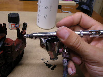

Here's my airbrush (Tamyia paints thinned with isopropyl alcohol work great):
Here's a better picture of the cup that fits in bottom feed. These are decent, but a little bit of a pain to clean.
